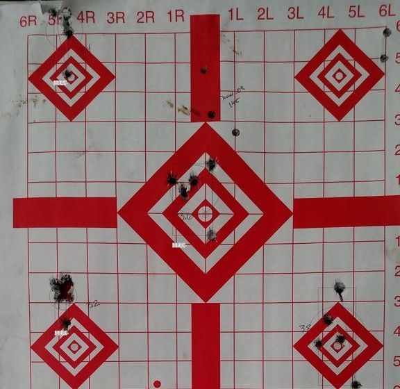

I am not surprised. This is the gun that in the past no matter what load combination I tried would only do 4" groups at 25 yards. I popped in the bushing last night and tested it this morning. The orange square is a 2 X 2" pastie. This group was shot with the new ACME 145 grain RN bullets and 3.5 grains of ETR-7. I think with a little more load development and some sight adjustments I might have an acceptable back up gun. I am smiling!!! :)
Yep, very similar to mine.  Had a factory slide/barrel/bushing that wasn't even good enough for a backup gun, now I have one good enough for a bullseye match, I think.  I'll know for sure by Sunday noon.
This is fun.
Joe

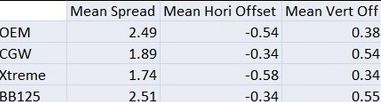

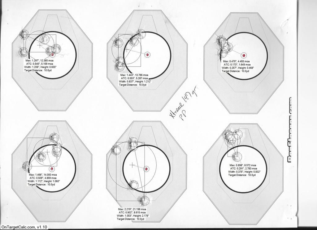

So I finally got out to shoot the SP01 Tactical with the new CGW bushing. I have compiled the most recent data from 60 shots using the OEM bushing and 60 shots using the CGW bushing.  These were all shot at 10yds for reference.  I used two different reload bullets for the comparison: Xtreme 147 RN on top of Power Pistol and BlackNBlue 125gr coated on top of CSB-5.  Here is the summary:
Here is a target using the OEM Bushing:
Here is a target using the CGW Bushing:
In general the results are positive.  I don't shoot this SP01 Tactical very well.  I shoot my 97BD much more consistently and accurately.  I think I need to do some new load development with the new barrel bushing to see if I can get to a better accuracy node with the BlackNBlue 125gr bullets.  I am happy with the Xtreme 147gr bullet load I am using.
