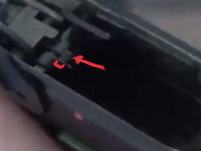

Just sent my pistol in this morning (The one in the video that was just posted). I will follow up with what happens and if the pistol is actually fixed. I did let them know that others have sent theirs in and have been returned with the same thing happening again so hopefully they take it seriously and don't just shoot a couple rounds then call it good. The first time it happened it was on the 14th round fired so it took a bit for it to work its way out. Im thinking the problem lies with the ejector being able to be pushed down too easy whether its by recoil or by fired brass slamming into it . Maybe they will put a stiffer spring in . If it happens again then I was thinking of ordering a firing pin block spring and replacing the ejector push down spring with that.

I don?t know what the little extended metal piece that retains the arm of the spring, but if it was extend further and had a notch underneath it to help keep the spring arm in place would that help keep the spring arm from coming dislocated?
That is part of the decocker lever. When the lever walks out, the spring never becomes disengaged from that lever. If it did, your idea would work.
The standard 75 has the spring as well as a detent plunger to hold the lever in.  The engineers at CZ removed the detent plunger in favor of only using the ejector.
The only way I see a fix is by creating interference with the right hand side lever, or making the ejector rigid, either py pinning in place or with a spring with a much larger spring rate.
